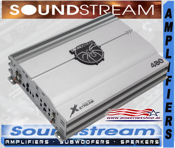

Resim nove zesiky a zajimal by me nazor,ktery bude lepsi :-))
vepredu kompa 100 RMS,vzadu ovaly 125 RMS
foto k příspěvku  od jenicek007
o 14.01.2008, 14:48 | jenicek007
Schwerer Aluminium - Kühlkörper
• Tarantula-Badge
• Crossover-Selektor
• Bi-Lineare Frequenzweichen (Hi/Full/Low)
• Frequenzgang 10 - 30 kHz
• Klirrfaktor 0,05%
• Signal-Rauschabstand > 96dB
• Eingangsempfindlichkeit 0,5 - 4 Volt
• Große gekapselte Anschlussterminals
• Lowpassfilter 30 - 500 Hz
• Highpassfilter 50 - 500 Hz
• Tri-Mode Funktion
• Dämpfungsfaktor > 200
• Bass-Boost-Switch
Zusatz-Ausstattung:
ab XTA480.2 und alle 4-Kanal Modelle
• Subsonicfilter 10 - 30Hz
• Subwoofer Equalizer 0 - 18 dB
XTA480.4
4 x 60/120 Watt RMS an 4/2 Ohm
Abmessungen: 254 x 61 x 348 mm

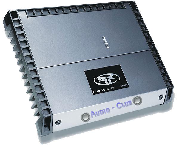

o 14.01.2008, 14:50 | jenicek007
4-channel car amplifier
25 watts RMS x 4 at 4 ohms (50 watts x 4 at 2 ohms)
200 watts RMS x 2 bridged output at 2 ohms (2-ohm stable in bridged mode)
Variable high- and low-pass filters (40-400 Hz at 12 dB per octave)
ParaPunch bass boost (0-18 dB, variable 35-70 Hz) with wired remote
Tri-way capable (Tri-Way Crossover required)
MOSFET power supply and output stages
CEA-2006 compliant
Preamp inputs and outputs
Fuse rating: 40A x 2
4-gauge power and ground leads with 80 amp fuse recommended - wiring and hardware not included with amplifier
o 14.01.2008, 14:52 | jenicek007
Max Power: 4 x 180W
Max Power:2 x 500W
RMS Power @ 4 ohms: 2 x 250W RMS (4ohms, 14.4V-BTL, 0.3% THD)
RMS Power @ 4 ohms: 4 x 90W RMS (4ohms, 14.4V, 0.08% THD)
RMS Power @ 2 ohms: 4 x 125W RMS (2ohms, 14.4V, 0.3% THD)
90 watts RMS x 4 at 4 ohms (125 watts RMS x 4 at 2 ohms)
250 watts RMS x 2 bridged output at 4 ohms (4-ohm stable in bridged mode)
CEA-2006 compliant
2-, 3-, or 4-channel output
Variable high-pass/low-pass filters (50-400 Hz, 12 dB/octave) 3
Tuned Bass EQ (12 dB bass boost at 50 Hz for channels 3 & 4)
Subsonic filter (15 Hz, 24 dB/octave for channels 3 & 4)
MOSFET power supply
STAR Topology
Gold-plated screw terminals
Speaker- and preamp-level inputs
Preamp outputs
Fuse rating: 30A x 2

o 14.01.2008, 17:53 | Augi
Já jsem pro SS...
o 14.01.2008, 19:56 | Zip
no a nejsou ty zesíky slabý, když dopředu to chce 100W a dozadu 125W? Nebo to půjde do můstku a jen na předek?
o 14.01.2008, 20:17 | jurassic
Ten rockford by byl pěknej dopředu na ty kompa v bridged, ale jak píše Zip, abys pokryl to co tam chceš dát bylo by lepší něco silnějšího, třeba:
soundstream je taky pěknej, ale RF je RF
o 14.01.2008, 21:08 | jenicek007
No zatim mam na predek na kazdy repro 55 RMS a zda se mi,ze je to OK a jak znamo RF ma vetsi vykony,nez pise,tak nevim
o 14.01.2008, 21:21 | Zip
Co to máš za komponenty? No nevím mít na 55W zesíku 100W repra, to mi přijde jako blbost, to nepoznáš co ty repra umí.
o 14.01.2008, 21:30 | jenicek007
GZ serie MK2
o 15.01.2008, 13:17 | CarMedia.cz
pokud SS, tak bych sel do TR 4100 nebo 4125..
o 15.01.2008, 15:40 | Barthez
Doporucuji RF :-)
o 15.01.2008, 16:00 | jdoizo
jako Pasatak, TRko, a RF není taky špatné, SS se dá sehnat za čupr peníze a tarantula je cool zes, zvuk, kontrola,výkon
o 15.01.2008, 16:59 | jenicek007
a co tahle tarantule?
Soundstream TRA680.4
o 15.01.2008, 17:05 | jenicek007
A koukam,ze nikomu nevoni ALPINA :-))
o 15.01.2008, 20:11 | Zip
Soundstream TRA680.4 je ale trochu cenově jinde než ty 3 co sis vybral.
Jinak alpine je dobrá volba, ale záleží jaká na ty tvoje komponenty
o 16.01.2008, 10:13 | jenicek007
Zip-je to cenove jinde,ale koukam,ze je asi lepsi TRA,tak skocim do toho.Kdyz uz,tak uz :-))
