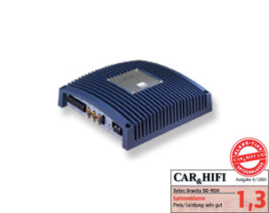

o 24.05.2006, 08:58 | VlastaCB
Gravity jsem srovnaval uz asi pred dvouma rokama ,byly na zesilovac 5G900
poveseny referencni repro od Rainbow (cena asi 120000,-)
Ty zesilovace fungujou i pri vysokem zahrati na 2 ohmech uplne uzasne (svitilo na ne slunicko celej den ,a drzely pri 2/3 vykonu)
Ty vykony co jsou napsany od vyrobce tak opravdu sedi
Za ty penize spickovej zvuk akorat se musi vybrat komponenty ktery snesou vysokej vykon (P2,P4) Gravity bych doporucil 4G600MKII
articlenumber 6
Channels 4 analog
Power 4 Ohm Watt rms 4x110
Power 2 Ohm Watt rms 4x180
Power 1 Ohm Watt rms /
Bridge 4 Ohm Watt rms 2x380
Bridge 2 Ohm Watt rms /
Filter Range Highpass Hertz 15-200
Filter Range Lowpass Hertz 40-200
Controls Top
Bass Boost /
Bass Level Control no
other features Active Kit Option
Output Stage HPAA
Fuse 2x30A
Dimensions mm 280x280x65

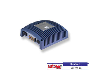

o 24.05.2006, 08:59 | VlastaCB
Nebo 5G900MKII
articlenumber 123
Channels 4 analog / 1 digital
Power 4 Ohm Watt rms 4x100 analog / 1x390 digital
Power 2 Ohm Watt rms 4x130 analog / 1x560 digital
Bridge 4 Ohm Watt rms 2 x 250 analog
Filter Range Highpass Hertz 15-200 / 10-50
Filter Range Lowpass Hertz 40-200 / 40-200
Controls Top
Bass Boost ParaQ
Bass Level Control yes
other features Aktive Kit Option
Output Stage HPAA / MosFet
Fuse 2x40A
