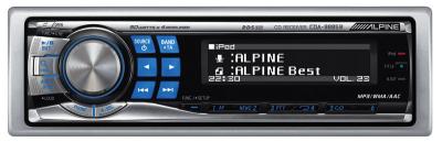

Je možné k tomuto radiu připojit usb přes nějaký adapter či modul?Nebo je to pasé...Díky za rady

External Device Controls
USB Adapter Ready: With the optional KCA-620M USB adapter (item number 500KCA620M), you can connect and control MP3 players that have USB connections. In addition, if you have MP3s stored on a USB thumb drive, you can select and play those files from the head unit.
iPod Full Speed: The CDA-9885 has an iPod Direct Connection mounted on a 4" pigtail on the rear panel. When used with the KCE-422i Alpine Full Speed Connection cable (500KCE422i, included in the box), your receiver can interface with most Apple iPods with a dock connector. You can quickly and easily search through all of the music contained on your iPod by Playlist, Artist, Album, Song, Podcast, Genre, or Composer. You can view artist, album, song, and track number on the head unit's display. The unit can be used with the following iPod versions:

BTW: najdenie toho linku mi trvalo asi 3sekundy:)Navyse uz aj na tej fotke co si sem uploadol je na displey-i iPOD z coho asi vyplyva ze sa bude dat nieco pripojit:P
