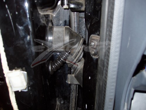

o 01.04.2007, 22:51 | kral007 (eXtrem-audio.cz) (M)

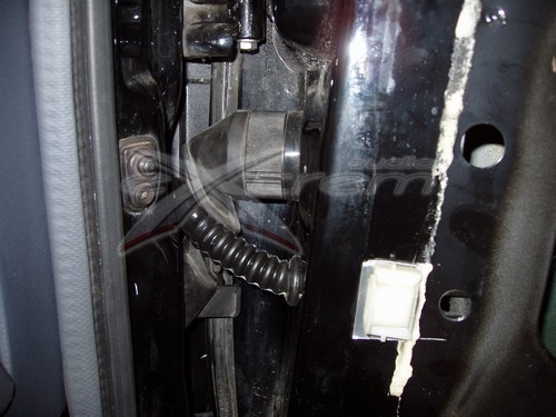

o 01.04.2007, 22:55 | kral007 (eXtrem-audio.cz) (M)

o 02.04.2007, 09:43 | kral007 (eXtrem-audio.cz) (M)
jinak treba stualarm
