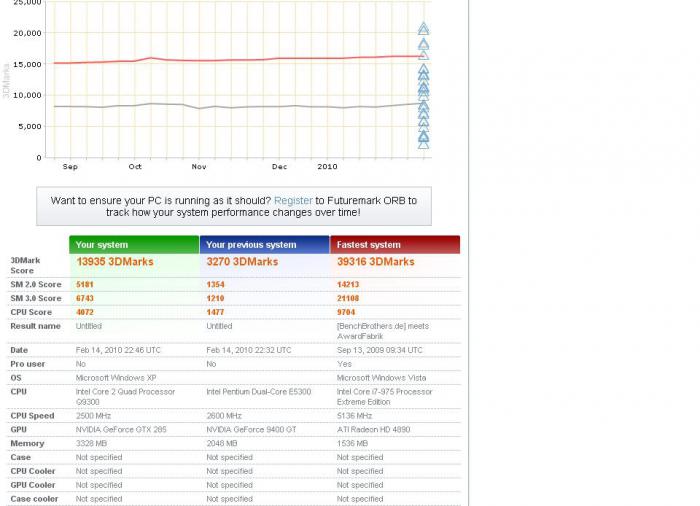

o 14.02.2010, 23:16 | xenonman | Upraveno: 2010-02-14 23:17:22
3d mark to projelo v pohode...
