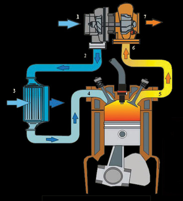

je to těžký uvěřit, ale asi nemáš pravdu, já tomu původně taky nechtěl věřit, ale koukni na todle o kinetický enerkii vejfukovejch plynů tam není ani slovo
The components that make up a typical turbocharger system are:
The air filter (not shown) through which ambient air passes before entering the compressor (1)
The air is then compressed which raises the air’s density (mass / unit volume) (2)
Many turbocharged engines have a charge air cooler (aka intercooler) (3) that cools the compressed air to further increase its density and to increase resistance to detonation
After passing through the intake manifold (4), the air enters the engine’s cylinders, which contain a fixed volume. Since the air is at elevated density, each cylinder can draw in an increased mass flow rate of air. Higher air mass flow rate allows a higher fuel flow rate (with similar air/fuel ratio). Combusting more fuel results in more power being produced for a given size or displacement
After the fuel is burned in the cylinder it is exhausted during the cylinder’s exhaust stroke in to the exhaust manifold (5)
The high temperature gas then continues on to the turbine (6). The turbine creates backpressure on the engine which means engine exhaust pressure is higher than atmospheric pressure
A pressure and temperature drop occurs (expansion) across the turbine (7), which harnesses the exhaust gas’ energy to provide the power necessary to drive the compressor
foto k příspěvku  od martin

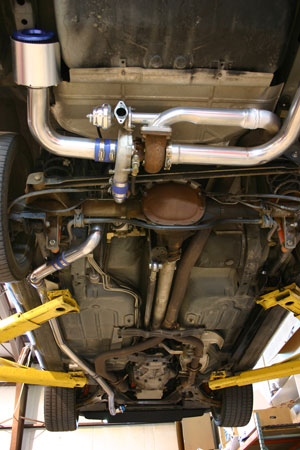

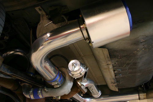

o 17.02.2007, 11:02 | MarauderZ28
ještě by mě zjímalo jak se chová turbo co není umístěno u motoru ...
o 17.02.2007, 11:03 | MarauderZ28
o 17.02.2007, 11:05 | tappaja
No podle me je umisteni u motoru z duvodu co nejkratsich trubek, aby turbo nemelo dlouhou odezvu a diru, nedovedu si predstavit, co musi to turbo nafoukat vzduchu do tech dlouhejch trubek na pozadovanej tlak.
o 17.02.2007, 11:08 | MarauderZ28
takže tam bude jako velká turbodíra ?
o 17.02.2007, 11:28 | Scream
by me zajímalo, co je tole za debilní počin a taky jakym zpusobem ma vyresenej odvod mazaní zpatka do vany. na konci toho vyfuku musí mít ty spaliny hroznou energii....
o 17.02.2007, 13:21 | blázen
než to dostane vzduch do válců tak stihneš vykouřit cigaretu .-))
o 17.02.2007, 13:33 | MarauderZ28
mno a přitom se to prodává jako ofiko celej kit ná zástavdu a dělaj to dlouho tak to asi nějak fungovat bude ...
o 17.02.2007, 13:36 | Scream
to ze se to prodava a je to na US ajúto jeste neznamena, ze je to neco dobryho. na konci vejfuku budou plyny studeny a pomaly nehlede na LAG
o 17.02.2007, 14:38 | MarauderZ28
já neříkám, že to je dobrý jen mě zajímá jak to funguje resp jak se to chová oproti autu co je má na svodech ...
o 17.02.2007, 15:07 | Scream
ty plyny se po ceste hrozne schladí a tim ztrací spoustu energie, aj si myslim, že efektivita je snížená o desítky procent.
o 17.02.2007, 17:38 | RedBaron
No tohle je fakt dobrej setup, teď už jen zbejvá aby amíci vymysleli auto, který bude mít motor vzadu a pohon přes kardan na přední kola :o)
o 17.02.2007, 18:07 | MarauderZ28
ještě existoval prototyp - tubína byla součástí zadní nápravy jako diferáku a to turbo přez nějakou převodovku či co pomáhalo hejbat poloosama, bylo to v 60 letech ...
o 17.02.2007, 18:33 | Nevřis
RedBaron..lol :)
o 17.02.2007, 18:43 | MarauderZ28
nicméně vypadá to, že to funguje docela schopně ...
o 17.02.2007, 19:03 | rossi.x
A vo tom to je :-) Ale v čechách to určitě fungovat nebude :-) Páč tady turba poháněj kamínka nebo hořáček lol....
o 17.02.2007, 22:51 | Scream | Upraveno: 2007-02-17 22:54:50
no to je jasny, ze to jede, kdyz to ma motor 6,0 nebo kolik s 400PSk tomu aspon nejakej plnícií tlak a jeste k tomu nitro. musí to jet jak krava i bez toho. ale auto je to krasny
o 18.02.2007, 00:08 | MarauderZ28

mno a jak pak může fungovat to turbo na konci kde je rozdíl teplot jen 150 stupňů oproti rozdílu 950 stupňů u motoru ???
o 20.02.2007, 10:39 | .mycTD
Mar: vyfukove plyny tam proudi furt, takze turbo se tocit bude, ale snizujes tim ucinnost
o 20.02.2007, 14:02 | ACEMajky
17/02/2007 11:02 MarauderZ28 - mozna tim resi to, ze se turbo tolik neohriva od motoru a od vyfuckovych plynu,a le to by se dalo resitjinak - chlazenim vodou + pred turbo zaradit chladic oleje, coz vlasne oni maji diky dlouhym trubkam,a le turbodira musi byt desne velka

o 26.02.2007, 14:04 | Ace_FIAT
Nevím jeslti ste se dobrali konce, ale v Autohitu byl článek na dvě A4 o turbu, tak to zkusím vložit.
foto k příspěvku  od Ace_FIAT
o 26.02.2007, 14:05 | Ace_FIAT
jde to celkem rozumně číst... Snad nebude problém s vlastnickými právy..
o 27.02.2007, 18:31 | CervinVega
v tom clanku je dost chyb, kdyz nic jineho tak tvrzeni, ze nelze pouzit valiva loziska ukazuje, ze autor je opravdu "znalec" jinak by mu asi tezko uniknul fakt, ze se uz leta bezne prodavaji :-)

o 02.02.2012, 04:21 | Jozzo
16.02.2007, 12:06 | .mycTD
choze: kdyz mas na jednom konci trubky teplo a na druhym zimu, tak tam proste bude pruvan.
jak to tady tak čtu tak jedu ráno kupovat suchý led ,budu chladit konec výfuku a nebudu potřebovat turbo,dám si to patentovat a vydělám miliony :-DDDDDD
o 02.02.2012, 07:25 | CervinVega
jozzo- neboj se toho, kdyz tu trubku udelas dlouhou a vytahnes ji nad strechu, pojede to samo .-)
o 02.02.2012, 08:15 | Dudelina
Tywe Jozzo, koukám není co na práci, takže projíždíš forum 5 let zpět jo? :-D
o 02.02.2012, 11:08 | .mycTD
Jozzo: bojim se, ze bez toho turba by ten pruvan* byl asi dost jalovej ;-)
o 02.02.2012, 11:34 | Jozzo
dudelina: hledam veci o turbech a kompresorech :)
.mycTD: ale kde,celý ten šílený tunel ve kterém bude ku.evský fučák napojím zpátky do sání a to bude mít takové tlaky že se každé turbo a kompresor můžou jít zahrabat !!! samožřejmě přes ventil to bude přisávat další čerstvý vzduch,bez něj by to nejelo,ale taky ho budu chladit...
o 02.02.2012, 11:37 | Jozzo
cervinvega: nebojím,udělám 20m trubky pod autem a samé ostré hrany ať se ten fučák oťuká a oseká a je zbyte tam jen pěkně vostrej průvan
